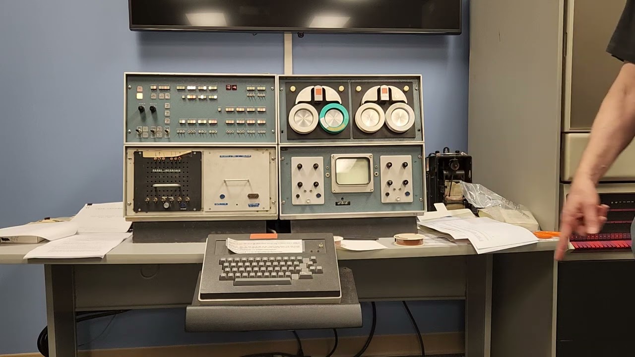

How’s the LINC emulator coming along? Running Spacewar yet?
Oh, well, I’ve become distracted… :-/
It seems, the game is similar to Spacewar for the PDP-4.
If there is interest, I’ve a transcript of the source code available.
Yes! Very much so.
(Add to make 20 characters.)
Here you are (including source context, 11MB):
https://masswerk.at/spacewar/sources/LINC-Spacewar.zip
I see, I actually wrote an assembler for verification (see the listing.txt for list output and octal object code at the very bottom of this) – I hope this does work correctly, never tested.

Thanks! I’m inspired to make a LINC emulator, maybe as an addition to SIMH. But not yet; no promises.

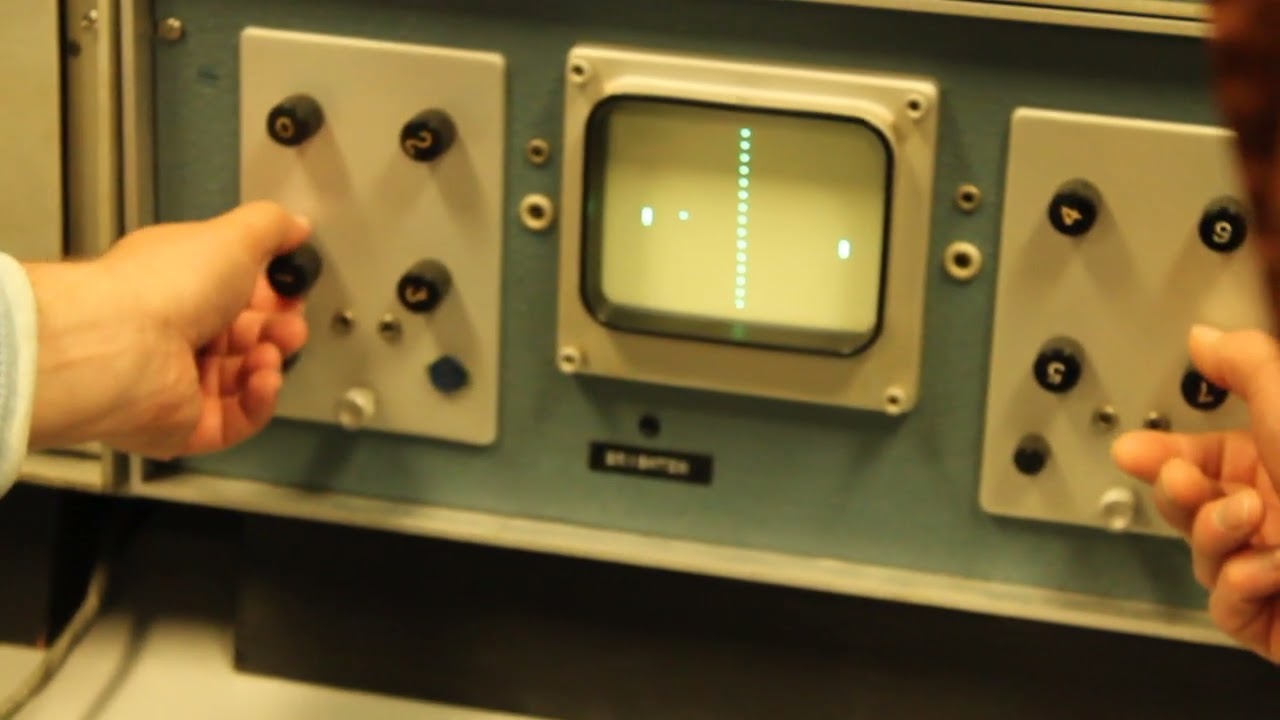

Here are two cool LINC videos made recently:
There’s however the challenge of somehow translating that haptic interface to a terminal environment: besides the keyboard and sense switches, there are also 8 knobs with a digital scan range of -177…+177, each.
I’m thinking something like this.

Me too. Mine runs your copy of Spacewar now. But I don’t know what to for the input devices.
It also passes most of these diagnostics: Directory of images/GJohns/classic-test.linc

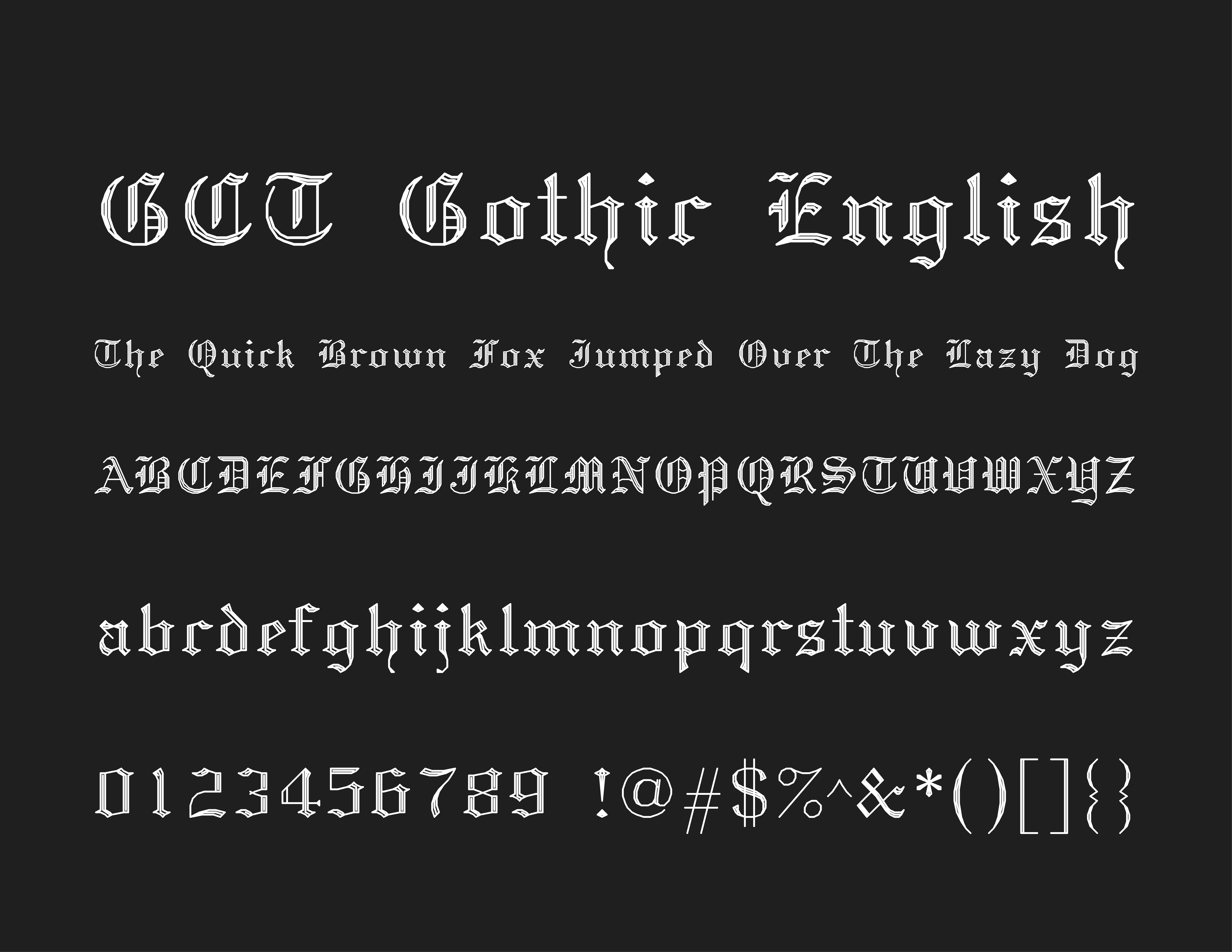

In a roundabout way, I recently did a conversion (of a subset) of these fonts as TrueType. IMHO they turned out excellent.
See: dps8m / font-gct-multics · GitLab
The full-width README might display a bit better for most users: README.md · master · dps8m / font-gct-multics · GitLab
This project wasn’t to convert the Hershey fonts, but the Multics GCT (Graphics Character Tables) to TrueType, and it just so happens the 12 Multics Graphics fonts are derived from the Hershey set.
I also developed a GCT linter and the opposite conversion tool, one which converted SVG stroked font data to Multics GCT for use with the Multics Graphics System.
For those that don’t want to click through to the whole page (at README.md · master · dps8m / font-gct-multics · GitLab) here you can see how the “Gothic English” font turned out in TrueType (selected to show here since it’s the most intricate) of the Multics fonts:
If there is demand I could probably do a conversion of the full Hershey font data using the same techniques. Although the process is >99% automatic, it is still somewhat time consuming if you strive for perfection.
