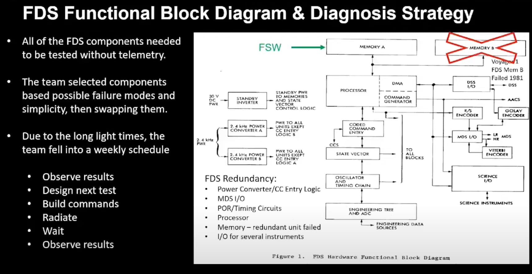

Nice technical talk by Bruce Waggoner about debugging and fixing another problem on Voyager - contains the information that the rate of change is increasing, presumably as the systems degrade. Also that the replacement staff for certain roles have now also retired. And that these computers - 3 architectures in each spacecraft, I think - are the longest-running computers we’ve ever made.
Cue up to about 11 mins for the computer related content.
The lightspeed turnaround time was just under two days at this time.
