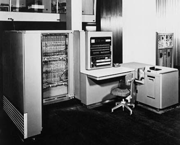

Help identifying a mystery (mainframe) machine
Maybe the IBM 1720 pilot system, of which only 3 existed. This was replaced by the 1710.
The CHM has a 1720 reference manual, maybe someone could ask them to see if it has pictures.
Yes, this is very weird.
Probably either a prototype or even a fake/movie props.
The cabinets are early 50s style, the panel including the label on top late 50s or rather early 60s. The 1620 and 1710/1800 have not that label/sign on top, but the 7000s.
The panel is also very small. That can’t be a full mainframe installation.
IBM is well documented. Nothing fits and nothing is even similar.
And is that a laughing lady behind a window on the left?
Cannot unsee. I think I now see the curve in the right window of that leftmost cabinet on the side as a reflection of the left window of the left one at the back of the room. I was previously trying to see it as something circular, like perhaps a drum, but the perspective didn’t fit.
Somehow the other reflections don’t fit. And what about the shadows?
There are at least 2 frontal light sources. And at least one from above
The shadow of the standing man is on the right cabinet.
But there’s another shadow next to his arm. Could be the right cabinet and the head of the sitting man. There’s another darker diagonal shadow. And next to his arm is a light boarder.
The cabinets with the windows look like as if they should be the same. But behind the windows they are different.
Mmm, I’m no longer thinking the circular feature is a reflection of the other window…
I think, this is a carefully arranged and lit publicity shot. There are so many shadows and light sources, and those shadows appear to be much too well defined for them coming from just some ambient ceiling lights (which should be more like areal lights). There’s a light source on top and behind that cabinet on the right, light coming from behind the scene (compare the shadow of the desk and the unit on the left), a strong light from the front right and and even a fill-in from the front left. I can’t think of any natural light that would behave like this.
Also, these are by no means real-life operators, but posing actors. Which also puts some emphasis on how they are posing, like the model on the right ā€œcasuallyā€ holding of all things a slide rule. This is certainly meant to provide context.

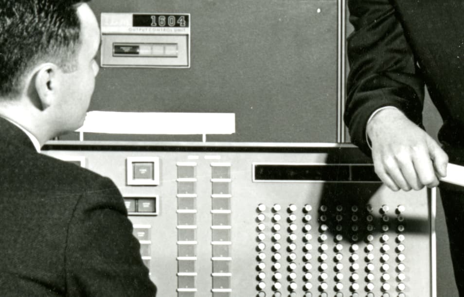

I’d failed to realise that, as a non-user of Twitter, I wouldn’t be seeing any of the replies. Looking over the post again, on twiiit.com or nitter.net, I see the bitsavers account has posted a link to a much much higher resolution version. In which we see that the cabinets are labelled 1601 through to 1605.
See here for example. And the big image, in TIFF format, is here.
Here’s a detail:

It is an IBM 1600 system (or 1601 following the conventions of the 1401) boxes left to right 1601, 1602, 1603, 1604, 1606.
http://bitsavers.org/mysteries/ibm1601.tif
1606 is the console. box on the left 1608. it sure looks like a process control system given some of the box names
if you look closely, there are wide paper tapes on the inside right of the 1601 and 1602. They insides look remarkably similar.
Assuming it is tube-based, maybe it ended up being too unreliable and expensive for industrial use.
the 1608 looks very similar to the 1712

Oh look, an IBM 701 photo has the same chair!
Edit: also this 705 chair in a tweet from Marcin Wichary.
Obviously not sold often, if any. I think we can call this prototypes.
Thanks Ed for solving this. And thanks for nitter. I also wondered if there were answers. And one day earlier I thought we need larger photos as the museum was the only source.
Some of my/our assumptions were right. The lady turned out to be a paper tape, though. I don’t think chairs helping here.
Maybe the chair is a standard IBM chair.
Could be - I was delighted to find a chair match, but also if we hadn’t already got better information, it might have helped rule out many other possibilities. (One commentator elsewhere thought the men’s suits looked Russian, which now seems to be very unlikely.)
