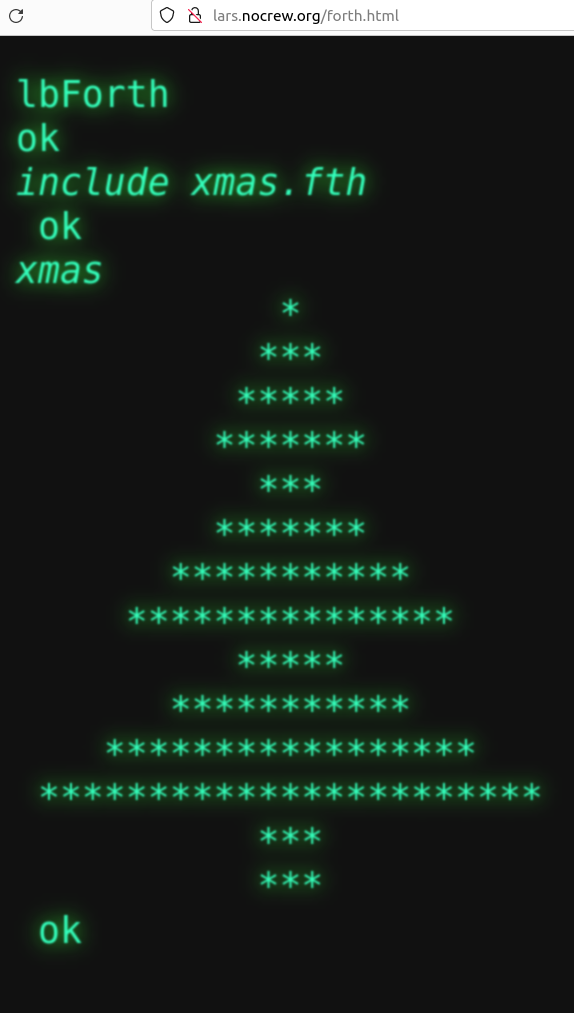

I’d like to suggest a more factored Forth solution:
: stars ( u -- ) 0 do ." *" loop ;
: branch ( u -- u ) 12 over 2/ - spaces  dup stars  cr ;
: section ( u1 u2 -- u1 ) 4 0 do  branch  over +  loop drop ;
: tree ( u1 u2 -- u3 u4 ) 3 0 do section  1+ dup 1+ swap loop ;
: root ( -- ) 3 branch branch drop ;
: xmas ( -- ) 2 1 tree 2drop root ;
