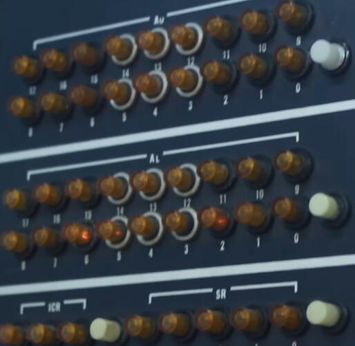

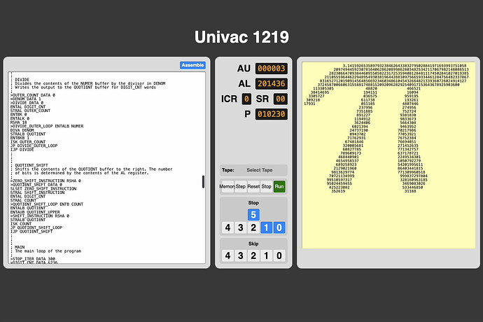

Nice video! Over the course of a year maybe, two people (building on the work of others) write a Univac emulator, assembler, RISC-V emulator, build a serial interface to load their code onto the real hardware at InfoAge, and bring up a Basic interpreter, a pi program, and much more.
Also an in-browser emulator
