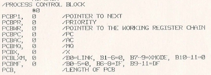

Each process has a Process Control Block (PCB):
It contains:
  • a forward pointer for making lists and queues
  • a priority, further described below
  • a pointer to a list of working registers (WR), analogous to what today we’d call a stack frame
  • programmer-visible state
PCBs and WRs were allocated as needed on what we’d recognize as a conventional heap, using alloc and free routines in PMIO. I called this based storage after PL/1 terminology; you can see this in comments. You’ll notice for example page 0 “variables for based storage routines”, with names that start with AF for alloc/free. You’ll also notice with great amusement on listing page 2 “SBSSIZ=600”—the total size of the heap is only 6008 = 384 words!

I can see two flaws in the system.
First, the PCB does not include the EAE step counter (SC). This would only affect the normalize instruction (NMI), which would cause a nasty bug if that instruction were used. Nasty because there would be a tiny but non-zero probability that the bug would be symptomatic, and those bugs are hell to find. NMI is generally used for floating point emulation, which I did not do, so it’s likely that I never used NMI. I don’t know if not including SC was an oversight or a deliberate choice, but if it was a choice then the absence of a comment saying so is a major sin.
Second, the judgement of I/O bound or compute bound is flawed because a process’s time slice is reset every time a process switch occurs. Thus a process may never make the desired transition from I/O bound to compute bound, depending on unrelated I/O activity. This was unavoidable because there was no way to read the current count in the interval timer and save it in the PCB. The evidence suggests that the interval timer did not come from DEC or the Air Force, rather I added it. If so I didn’t provide for reading the current count, bad on me.
