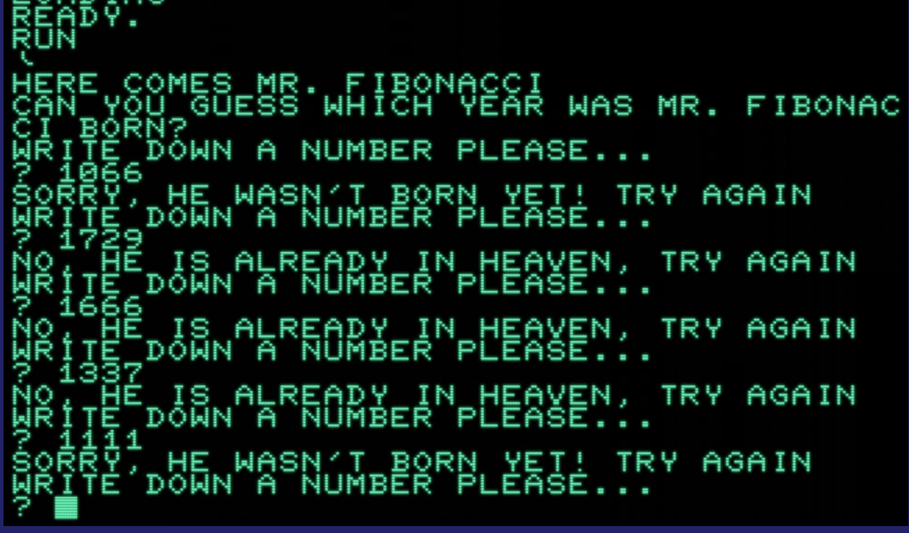

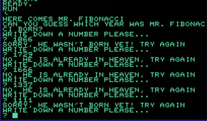

Here’s the first one, which you can run here in @NoLand’s PET emulator. I’ve pasted it as-is, lower case and all:
8 print "J"
10 print "here comes mr. fibonacci"
20 print "can you guess which year was mr. fibonacci born?"
30 print "write down a number please... ": inputc
31 ifc = 1170 then print "you are correct! now we start": go to 150
50 if c > 1250 then print "no, he is already in heaven, try again": go to 30
60 if c < 1170 then print "sorry, he wasn't born yet! try again": go to 30
70 if c > 1170 < 1250 then print "he would be ";c-1170;" years old"
71 print "now can you guess?": input c
72 if c = 1170 then 31
73 print "you are wrong. try again.": go to 71
150 print "up to which number do you want me tell you all the fibonacci numbers"
151 input n
160 print "J"
190 print "okay. here they go"
200 s=1
210 t=1
220 if s > = n then 270
230 if t > = n then 270
240 print s; t;
250 s=s+t
260 t=t+s
265 go to 220
270 print
271 print "another game, while fibonacci is waiting (y), or no more? (n)": print
272 get c$: if c$ = "" then 272
273 if c$ = "y" then 150
274 if c$ = "n" then 300
280 go to 272
300 print "mr. fibonacci is leaving now,"
310 print "and wishes to see you again sometime in the future"
312 print
313 print
315 print "here goes his car!!!!!!!!"
320 print "(brmmmm-brmmmm-putt-putt-vraow-chatter-chatter bye mr. fibonacci!)"
390 go to 450
410 print
420 print
445 nexti
450 end
