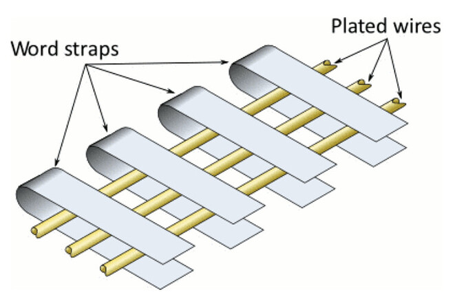

I was reminded of the plated-wire memory used in HP’s 9100 programmable desktop machine - there’s a nice explanation here
Also noted on that site, the use of similar plated-wire memory in Univac machines, found to be insufficiently reliable:

As an interesting note all systems of this series used a magnetic thin film memory, a then revolutionary development which, unfortunately turned out to be the most error prone part of these computers. One of the main advantages over then conventional core memory was the non-destructive read out which allowed for shorter memory read cycle times.
Due to the insufficient reliability of this memory system the complete subsystem was eventually replaced by an even more modern semiconductor memory system using some of the first memory chips made by INTEL. More than 1200 of these chips were necessary to implement the 256 kB of our machine.
The Univac brochure is more positive of course:
Construction is very simple, relatively inexpensive, and inherently reliable. Since the wire carrying the thin flm is also part of the memory circuitry, the number of components in the memory structure is reduced and its electronic operation simplified.
