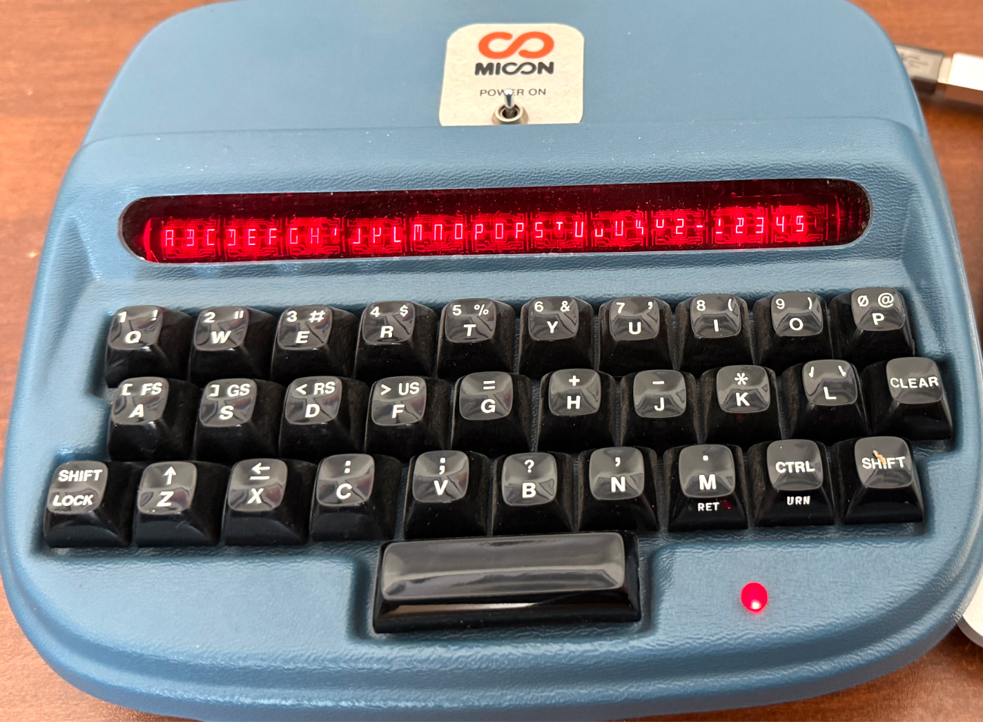

Yes, that’s me.
It’s a terminal I acquired just recently. Unfortunately, it didn’t come with any documentation so I’ve basically played with it and figured some of it out through trial and error. I connected it to a PC via null modem cable for testing (via TeraTerm). I configured it to add linefeeds to incoming carriage returns.
The Miget has four dip switches on the bottom but I haven’t explored those any further. It came with a cable that I’ve been told is a V.35 cable and that might have been used to connect to older routers. Perhaps for console access? I don’t know for certain.
Interesting vacuum-formed case, but the LED displays make for interesting character choices. Looks like 7 segment but with an additional vertical segment centred in the top?

Yes, not the sunburst display (the ones with diagonal segments) you may expect. I do like the characters, though.

An interesting adventure! The one large DIP visible in your photos is a UART, the AY-5-1013A, so I think the second DIP, on the hidden side of the keyboard PCB, must be the brains of the operation. Presumably a single chip microcontroller with just a little internal RAM and enough ROM.
For the record, I tried to take it apart further to see what that chip was when I originally took these pictures and that keyboard board is not budging so I had to leave it alone for fear of breaking it.
Ah - perfectly justifiable, of course!
