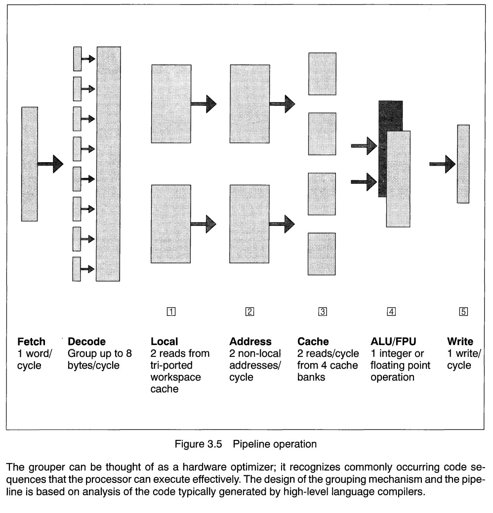

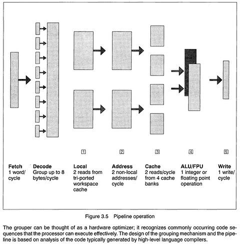

The official T9000 Hardware Reference Manual has some things to say about the pipeline and the instruction grouper, and shows how several instructions can be launched in each cycle. See p10 (p33) and also p74 (p96) of the PDF.
Since the processor can fetch one word, containing four bytes of instructions and data, in each cycle it is possible to achieve a continuous execution rate of four instructions per cycle (200 MIPS). However, if any of the instructions require more than one cycle to execute, then the instruction fetch mechanism can continue to fetch instructions so that larger groups can be built up. Up to 8 instructions can be put into one group and there may be five groups in the pipeline at any time.
During my tenure, some preliminary work started on a successor to T9000, which as I recall was to involve out-of-order machinery (Tomasulo’s algorithm as “first implemented in the IBM System/360 Model 91’s floating point unit”)
The major innovations of Tomasulo’s algorithm include register renaming in hardware, reservation stations for all execution units, and a common data bus (CDB) on which computed values broadcast to all reservation stations that may need them. These developments allow for improved parallel execution of instructions that would otherwise stall under the use of scoreboarding or other earlier algorithms.
