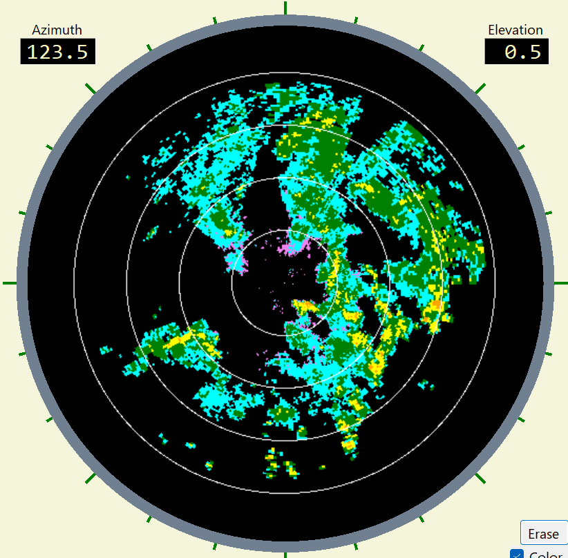

Here is Nexrad map from a storm last week, rendered in my PPI display (same display you saw in the video):

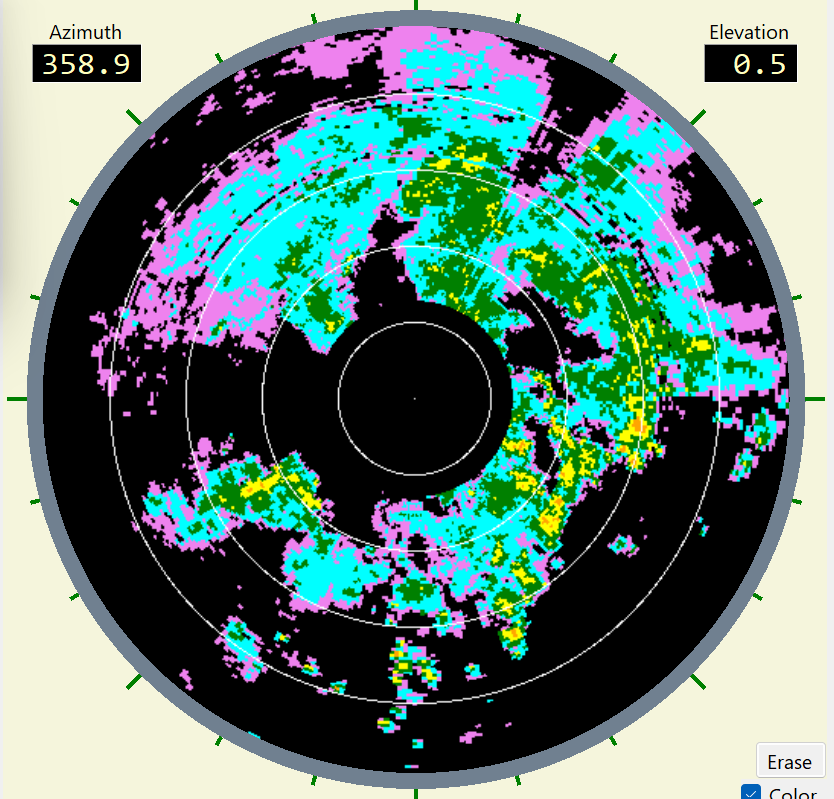

This display was made from unmodified dbz values directly from the radar. When I processed the map with the PDP-8 RADAR system, I got this:
When I saw the difference I assumed I had some sort of bug, and spent hours looking for it. But it’s no bug. The Nexrad radars are way more sensitive than what we had in back in the day. WR66, as the name implies, is 1966 technology. Nexrad can detect incredibly low signals at great distances, where the inverse square law attenuation is well beyond the reach of the old radar sets.
Those purple shades are below 10 dbZ at 250 km from the radar. Looking carefully at the PDP-8 code I estimated that at that distance, signals below around 30 dbZ are undetectable by the old sets. Remember that 30 dbZ is 100 times more received power than 10 dbZ.
So why am I sure that this is not a bug, and is explained by sensitivity? I looked at the one dbZ map preserved from the old days, the one presented at the 17th Conference on Radar Meteorology in 1976, and sure enough the lowest recorded value at 200 km was 28 dbZ.
Note that in the two images, the differences inside the 50 km range ring are due to different settings of the range covered by the display, which I wasn’t paying close attention to when I made it.

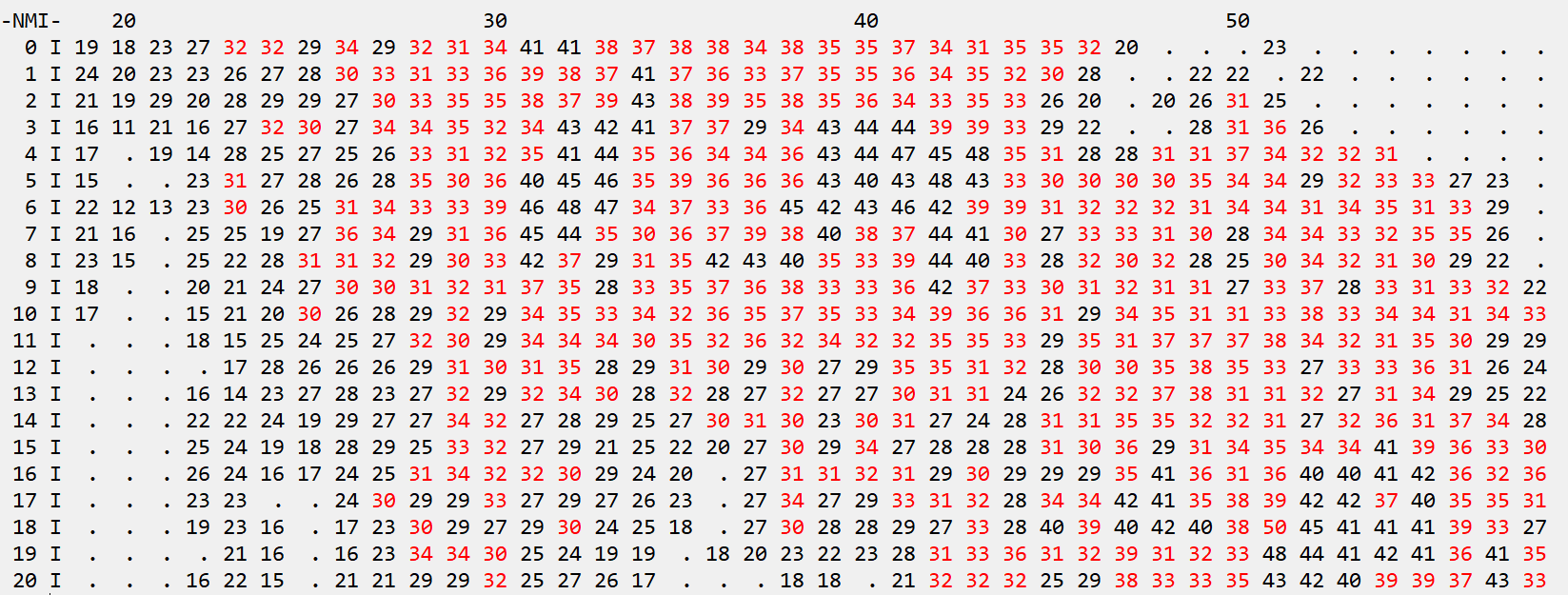

Here is a B-Scan made by the PDP-8 of a slice of a storm right now on the North Carolina coast. Azimuths are 0 - 20, so NNE of the radar. Range 20 - 60 nautical miles. Notice the small black areas in the 40 dbZ range, with peaks at 48 dbZ, which is pretty serious rain.
What I meant by that is there are a couple of hardwired calibration constants in the code, for each radar, that effectively set the lower limit of detectability as a function of range. I’m considering modifying the constants for one of the two radars to try to mimic the Nexrad sets. I think I’ll try WR66, like Nexrad a 10 cm (S-band) set, and with much more transmitted power than WR73.
I could indeed change the two WR66 hardwired calibration constants to mimic a radar with much more sensitivity, and the result is that the PDP-8 can closely replicate the weak Nexrad values at long ranges without changing the previously detected values. But I couldn’t just change the defined constants and reassemble–some two’s complement hacking was required.
