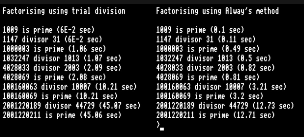

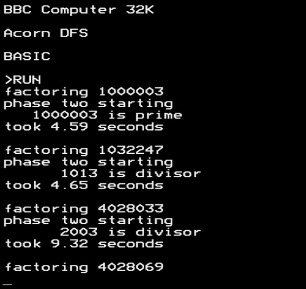

Rather excellently, ChrisB over on Stardot has ported the bulk of the factoring work to 6502 assembly, which shows off the ever-increasing speedup of Alway’s method quite nicely:
In summary:
Factorising using Alway’s method vs trial division by odd numbers
1147 divisor 31 (0.11 sec) 2.2x slower
1032247 divisor 1013 (0.5 sec) 2.2x faster
4028033 divisor 2003 (0.83 sec) 2.5x faster
100160063 divisor 10007 (3.21 sec) 3.2x faster
2001220189 divisor 44729 (12.73 sec) 3.5x faster
