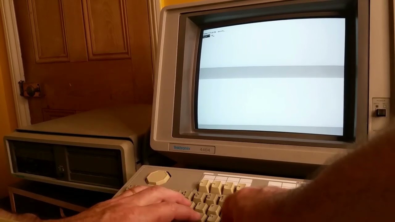

It feels worth highlighting your video showing the 4404 selftest (including sound test!) and a demo of Uniflex and then smalltalk, then your own windowing system, and microemacs:
Interesting scrollable 1k x 1k display with a 640x480 visible area!

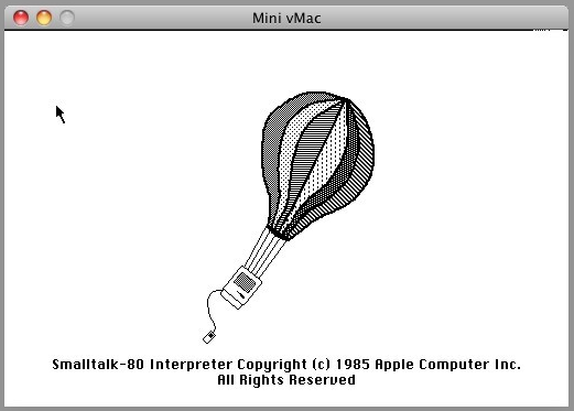

Back when I was researching the history of Smalltalk, I found out that Xerox had released three versions of it to three computer manufacturers as a “field test”: Apple Computer, Digital Equipment Corp., and Tektronix. The interesting thing for me about the Apple version is they actually made it available to developers, but they didn’t advertise it. This fact just got around by word of mouth. People had to write in to Apple to get a copy, and they’d ship it to them just for the cost of shipping. You needed what was considered a powerful machine to run it, though. I read that people who ran it typically used a Lisa 2, with 1 MB of memory. I guess a Mac Plus would’ve worked, too.
It was nice seeing the Tektronix version. It reminded me a lot of a demo I saw from Georg Heeg, who ran it on an Atari Mega ST (in emulation). It ran just like this. Since the full screen size didn’t fit in the Atari’s monochrome mode, the screen scrolled around. What astonished me is that a commercial version of Smalltalk-80 was actually sold for the Atari ST by ParcPlace Systems. I thought gosh, if I’d known that at the time, I would’ve bought a copy, since in the early '90s, I was using a Mega STe. I would’ve needed a monochrome monitor to run it, but I would’ve gone through with it. :slight_smile: That would’ve been thrilling!
You had to be part of Apple’s development program to buy Smalltalk from them. It was very low cost, but a bit more than just the cost of shipping. It came in 7 floppies and there was a little program to join the pieces of the image and sources file once you copied them to a hard disk. There was also a stripped down version which fit those files in a single floppy and could barely run on a 512KB Mac.
I was lucky to know a guy who was in the development program and got him to buy it for me.
You can download the Apple version from the Macintosh Repository site, nowadays.
For compatibility, this page states:
Per pre-release documentation, this will not run on an original Macintosh, the Mactinosh 512K could only run a stripped down version, and the Macintosh XL with 1 MB RAM was required to utilitize the entire program.
https://www.macintoshrepository.org/2187-apple-smalltalk-80
Damn that must be a tight squeeze in 1MB! Smalltalk does generate a lot of instances (and garbage) - I believe the received wisdom was virtual memory (VM) was essential to run anything but trivial code in Smalltalk.

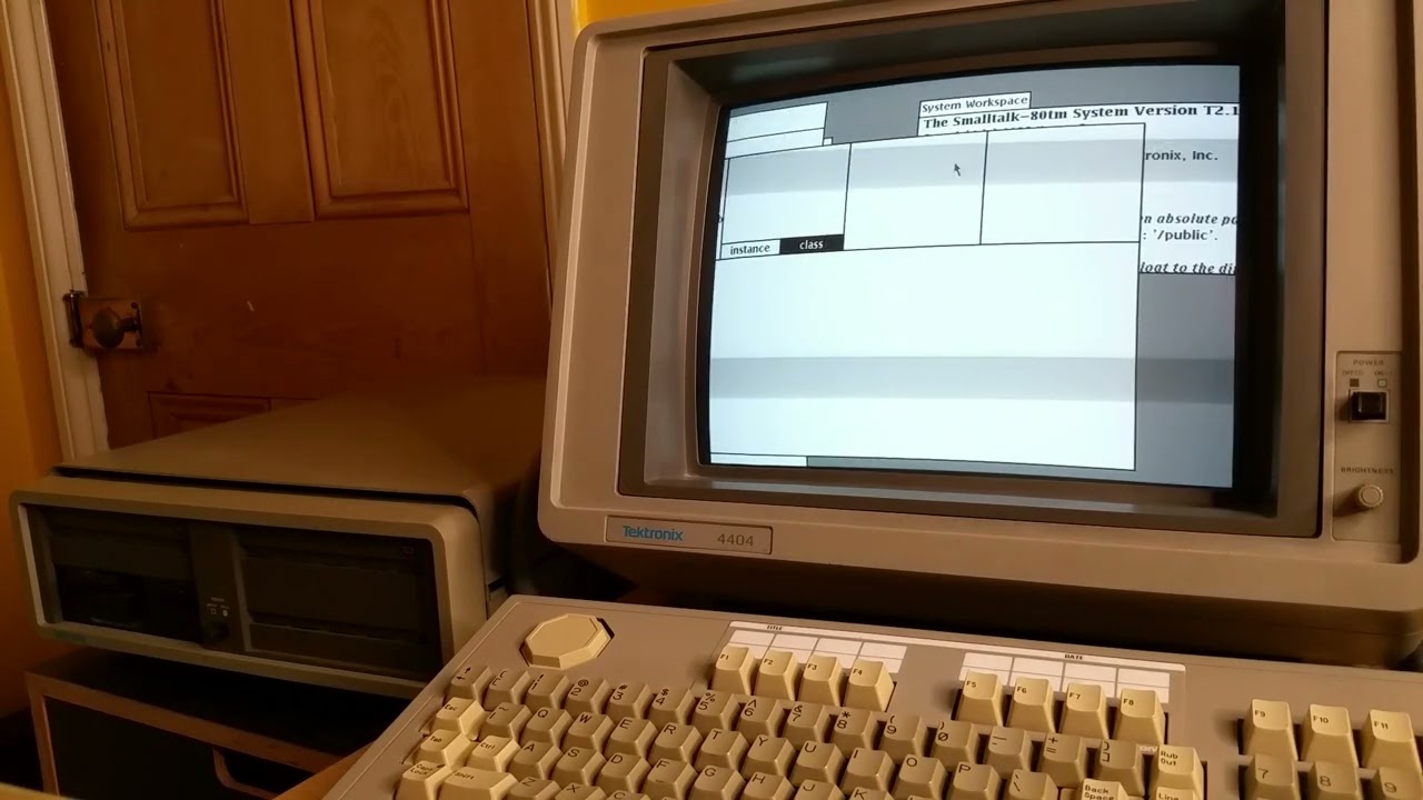

Short clip from a longer vid showing Smalltalk-80 running on Tektronix 4404 with 2MB of memory / 8MB virtual memory and hardware scrolling display.
