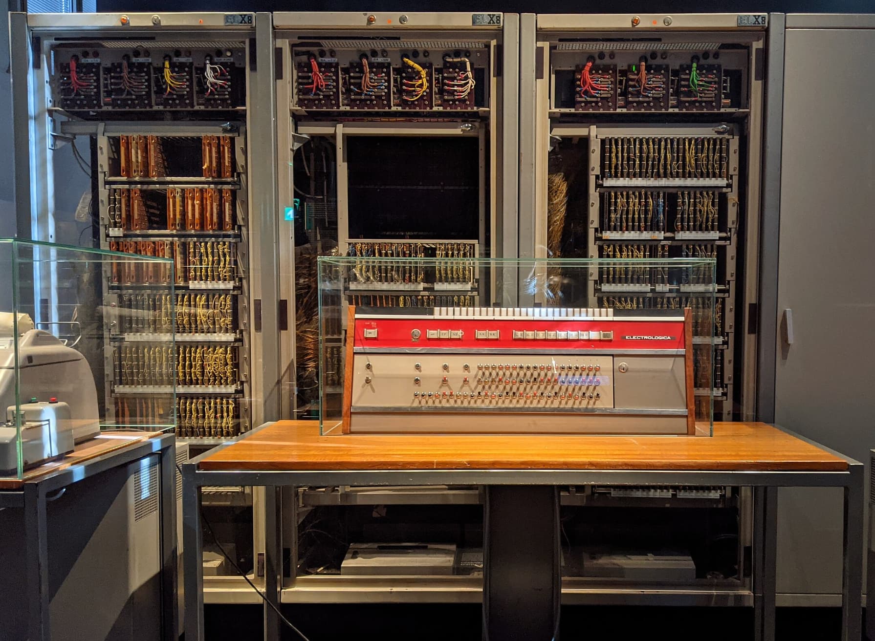

From wikipedia, here’s the Electrologica X8, being the successor to the X1:

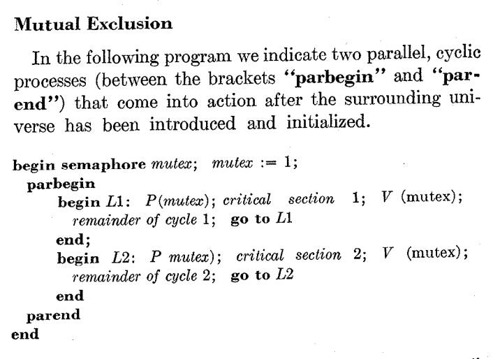

Wikipedia notes that the machine introduced the semaphore, a primitive needed for the operating system. Dijkstra’s paper describes sequential processes and even has some pseudocode looking rather like Occam to me, although the whole effort comes 10 years before Tony Hoare’s Communicating Sequential Processes.
That kind of pseudocode (to my eye it looks much like Pascal, but it is probably more Algol-y in origin) is very common in classic algorithm papers. Looking at that takes me back to university…
Is there a pseudocode standard? I often see it, but never a formal define for it.
I would not expect one - just write text which looks like the kind of code you have in mind, in whatever minimal syntax makes sense.
