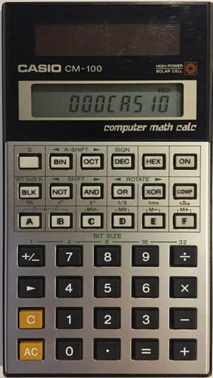

Another example - although examples are not what the OP asked for - mentioned recently by flibble in the stardot discord:
That’s the Casio CM-100 “computer math calc”

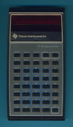

I see a page on TI’s TI Programmer with a photo:
