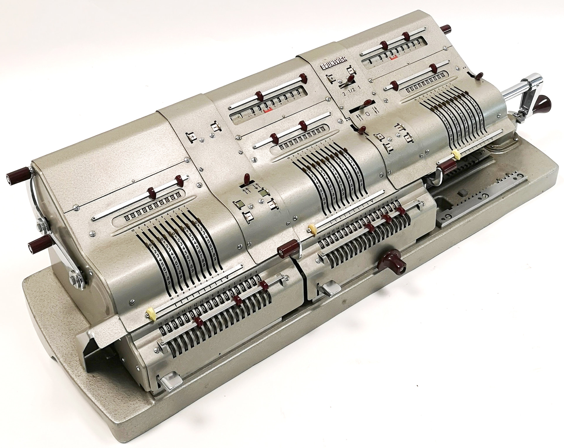

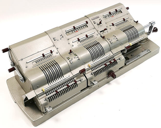

Archimedes, Badenia, Brunsviga, Diehl, Euclid, Thales, Triumphator, Walther: These were machines from the golden age of mechanical computing. They had no printing mechanism and were primarily used for adding, multiplying, and dividing. In the late 1950s, the engineer Willi Faber created a machine in the East Westphalian town of Neesen that could also square numbers and extract roots.
Here’s a missing square root function:
Caption: Brunsviga triple calculator… There would be space for the automatic root extraction function in the upper left corner.

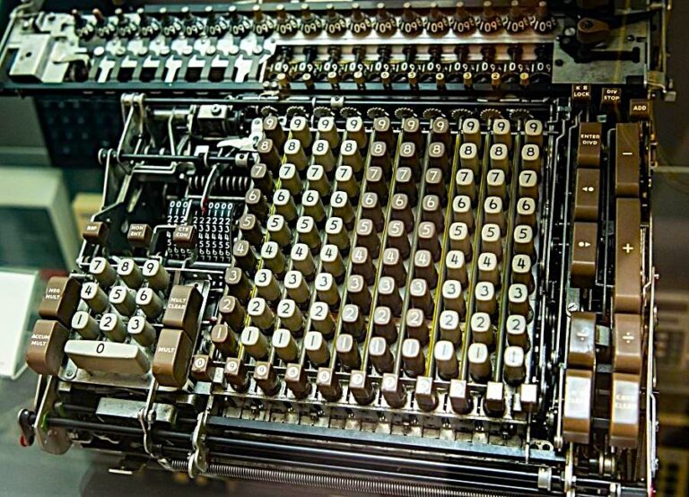

CT scan of a Curta (pepperpot) mechanical calculator

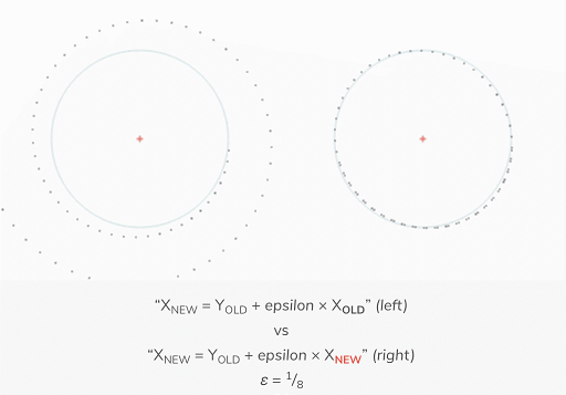

XNEW = XOLDepsilon × YOLD
YNEW = YOLD + epsilon × XOLD
This, however, is not a circle and will result in an increasing spiral.
Somehow, Minsky’s error self-corrects this. It will be still not exactly a circle, though, rather a fat ellipse rotated by 45°.

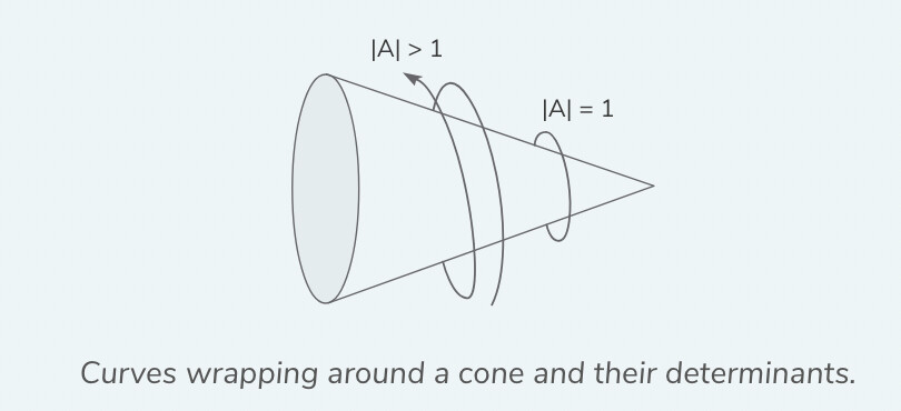

So, how does this work? Well, for any conical (function which wraps around a cone), we can tell from its determinant (|A|), if it is to return to where it started. Only if this is 1, the conical will loop.
So, looking at our defective shortcut version,
which is
⎛ xn+1 ⎞   ⎛ 1   −ε ⎞ ⎛ xn ⎞
⎝ yn+1 ⎠   ⎝ ε    1 ⎠ ⎝ yn ⎠
the determinant is (1×1)−(−ε×ε) = 1+ε² > 1, thus the spiral.
However, the Minsky version gives us
⎝ yn+1 ⎠   ⎝ ε  1−ε²⎠ ⎝ yn ⎠
which indeed cancels out the error (ε²): (1×(1−ε²))−(−ε×ε) = 1−ε²+ε² = 1
So, while not exactly a circle, it will still loop and with small values of epsilon (as may be achieved by right-shifts), it will be close.

Finally, for the more visually oriented, here’s a visualisation of the relation of conical functions and their determinant. (This is from an unfinished blog post about the “Minskytron”, I wrote a few years ago, which became much too long to be of any use.)
