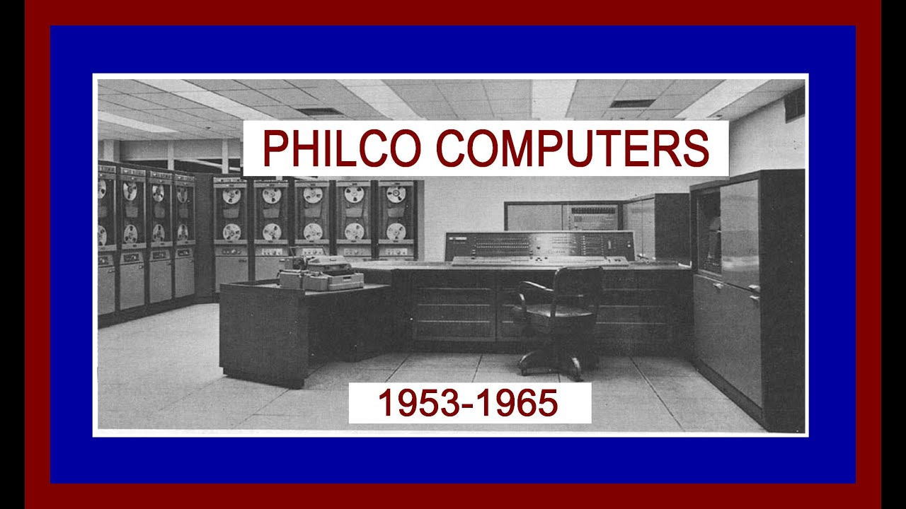

I found a few in “A Third Survey of Domestic Electronic Digital Computing Systems” a huge 1961 document from the Ballistic Research Laboratories. From there, for starters, here’s the transistor-based Philco 2000:
Here’s a video about Philco and their machines:

  • PHILCO 2000
    Philco Transistorized Automatic Computer (TRANSAC S-2000) as seen in video above. 20k transistors. 4 microsecond add time (variable.) “There is one 48 bit register, three 24 bit registers, and up to 32 optional index registers. The program section has asynchronous logic. Automatic assembling and compiling system called TAC”
