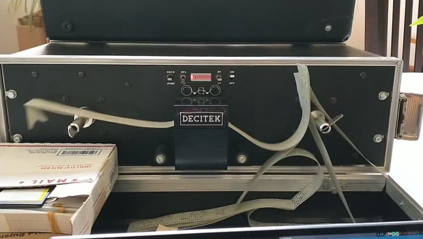

That is truly satisfying to watch. I recently read some fan-fold tape as a favor to someone who wanted to preserve code from their school days, but my high speed reader is designed for reels, not fan-fold; it was somewhat messier:
