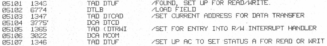

I have one more error. This is from your latest radar.lst from https://retrocomputingforum.com/t/preservation-scanning-and-ocr-tactics-for-old-printouts/5592/23:
This is the original listing:
As you can see, the badly printed 6 at location 5101 has been OCR’ed to 0. For comparison, the other TAD DTUF at 5107 is correct.
Yes, that’s an OCR error. Called it a 0 without warning. I’ve updated radar.lst. The old link now points to the correct version.
