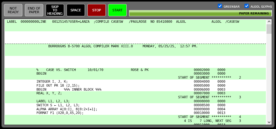

My Burroughs B5500, Burroughs 220, ElectroData/Burroughs 205, and IBM 1620 emulators will optionally output greenbar on their emulated line printers. The emulators run in a web browser and the printer output goes to an <iframe>, from which it’s possible to send it to a physical printer or create a PDF. No holes, though – I gave up on that a long time ago. Here’s a shot of the B5500 printer:
