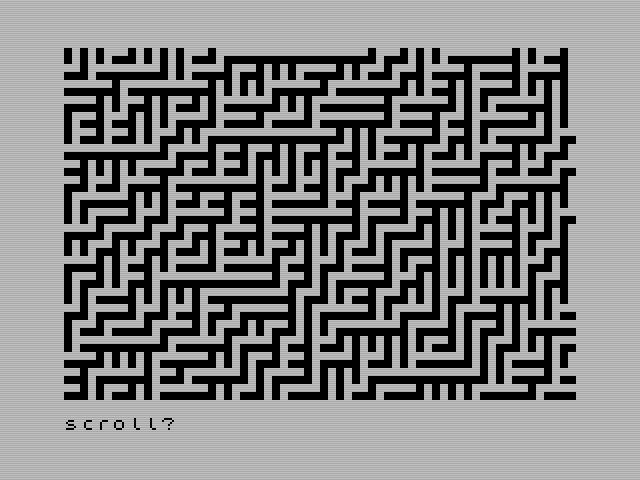

David Jones posted an elegant version of 10PRINT on the ZX81:
5 LIST
10 PRINT " ▌▄"(1+RND);
20 GOTO 10
Using Sinclair BASIC’s string slicing syntax, it’s very compact. It’s stymied from being a one-liner by the ZX81’s insistence on one statement per line. It can be expressed on one line on the ZX Spectrum, however:
10 PRINT " ▌▄"(1+RND);: GO TO 10
The infinite scroll is banjaxed by the scroll? prompt, alas.

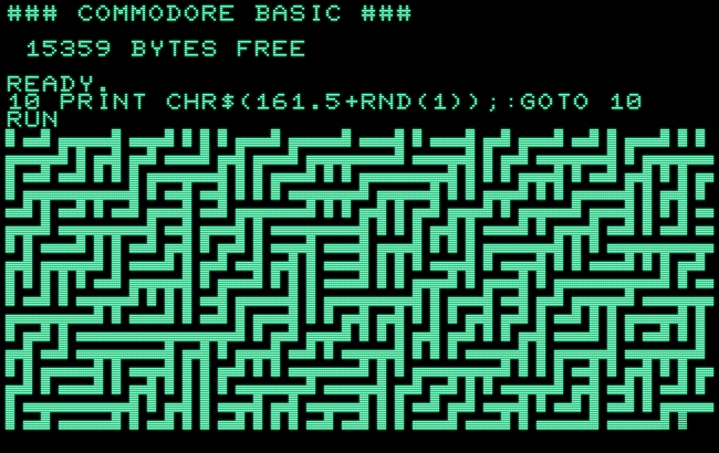

The aforementioned maze
10 PRINT CHR$(161.5+RND(1));:GOTO 10
looks like this (with the original PET character set):
We can make this slightly more elegant by using CHR$(181) and CHR$(184), as in
10 PRINT CHR$(181+INT(RND(1)+.5)*3);:GOTO 10
but this is also noticeably slower.
We can speed this up a bit and make the code more elegant by exploiting the fact that Commodore BASIC encodes true as -1 and false as 0, thus arriving at
10 PRINT CHR$(181-3*(RND(1)>=.5));:GOTO 10
Which looks like this:

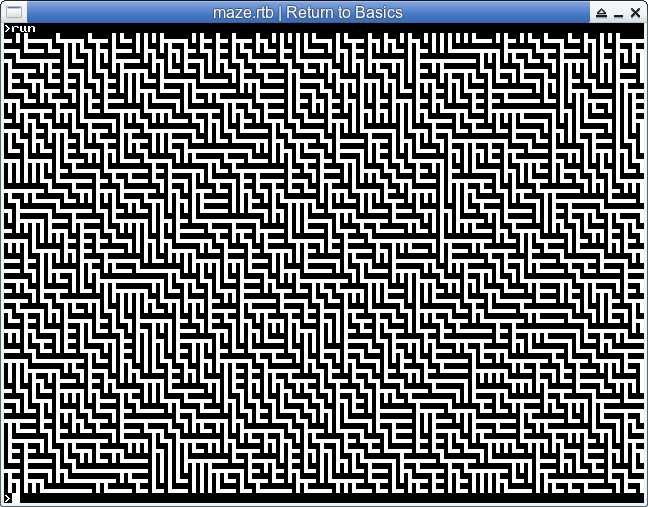

Slightly more verbose in my own RTB Basic:
defchar (190, 0x0F, 0x0F, 0x0F, 0x0F, 0x0F, 0x0F, 0x0F, 0x0F, 0x0F, 0x0F)
defchar (191, 0,0,0,0,0,0,0xFF,0xFF,0xFF,0xFF)
for i = 1 to tWidth * (tHeight-2) cycle
  vdu 190 + rnd (1)
repeat
end
(characters are 8x10)
And the run:

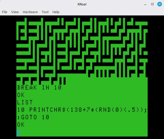

CoCo:

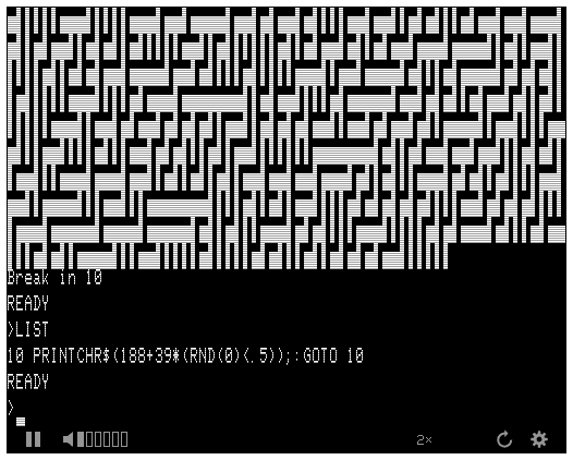

TRS-80:

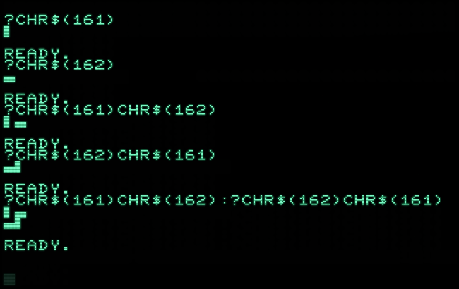

(We may discern that PETSCII code 161 is a half-filled character block to the left and PETSCII 162 a half-fill at the bottom. If we get two characters of the same kind in adjacent screen positions this forms a passage, if not, it will be some kind of a corner.
Notably, the maze produced by the combination of these two characters will have some bias regarding how its “paths” are formed, as they are only turn-symmetrical in a single direction, but not symmetrical along any of the major axes.)
