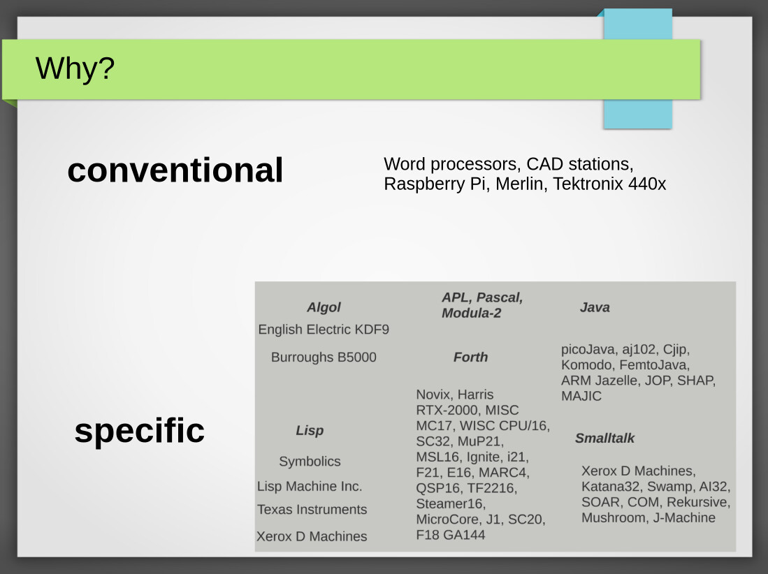

This is a slide from my 2019 talk about Smalltalk computers where I list some other language specific computers.
Great slides! I should have recalled the KDF9 and the Rekursiv.
