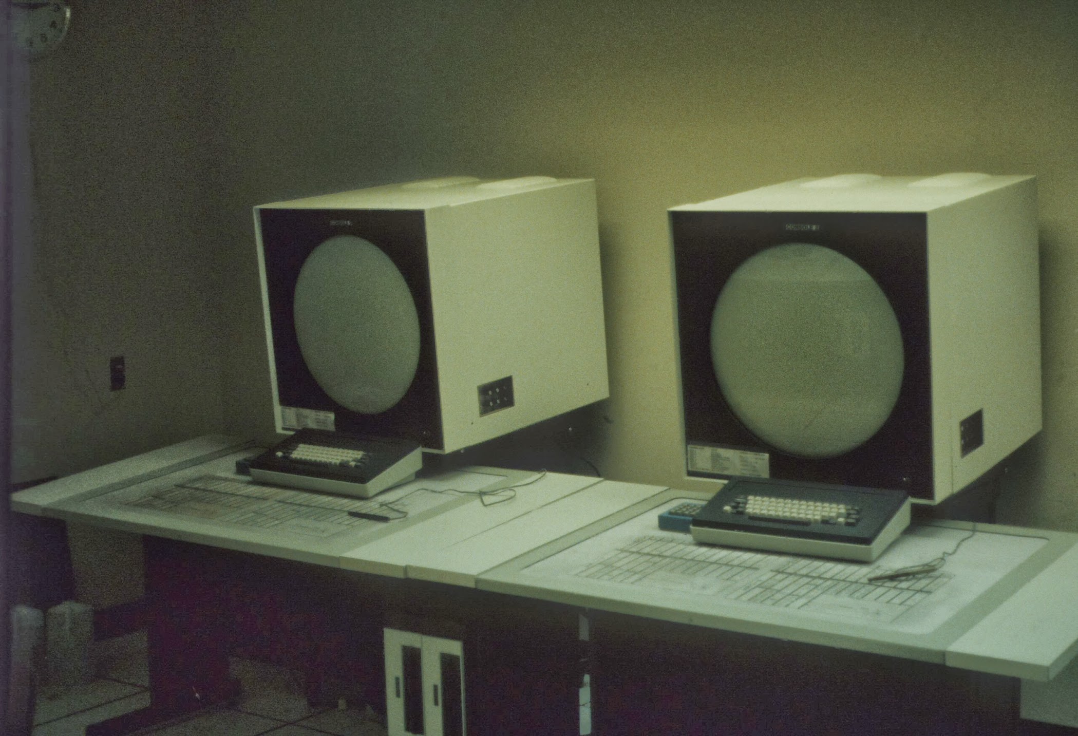

The Camex 135s at the Boston Globe.
Oh, it’s good to see a photo! At least for me, this makes history come more alive.
Those look like Microswitch keyboards. Similar units were in use at this time period with the Stanford AI lab Data Disc displays, the MIT AI lab Knight TVs, the Lisp machine “spade-cadet” keyboards, the MIT Logo PDP-11, etc.
