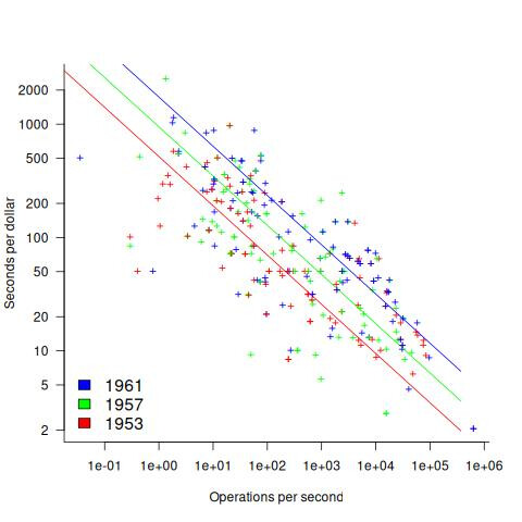

The plot below uses Knight’s 1953-1961 data, and shows operations per second against seconds per dollar (a confusing combination, but what Knight used), with fitted regression lines for three years using Knight’s model

It so happens that the value of the Knight’s fitted exponent is close to that proposed in a 1953 paper (“High speed arithmetic: The digital computer as a research tool”, no online copy):
  It used to cost one cent to do a multiplication on a
  desk calculator; now it is more like four cents; but
  with these big machines we can do a million in an hour
  for $400, and that means twenty-five multiplications
  for a cent! I believe that there is a fundamental rule,
  which I modestly call Grosch's law, giving added
  economy only as the square root of the increase in
  speed-that is, to do a calculation ten times as cheaply
  you must do it one hundred times as fast.
which did indeed become widely known as Grosch’s law.
