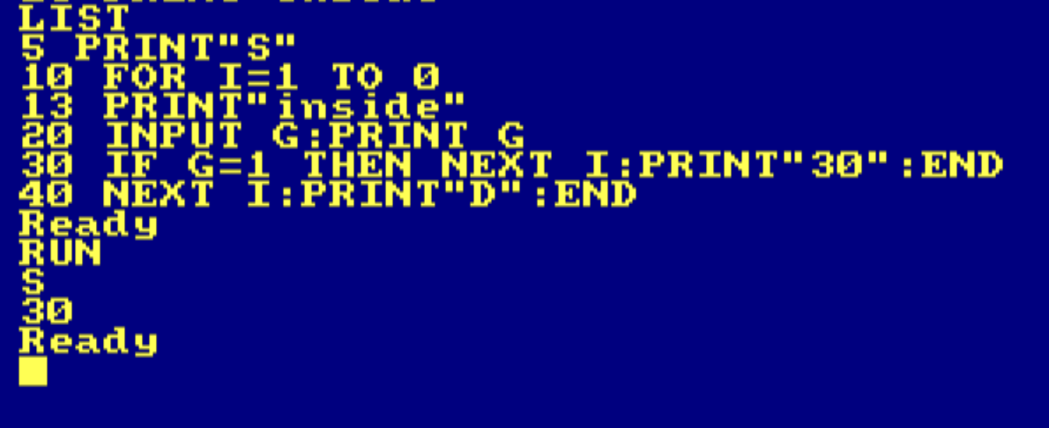

Interesting. I tried on CPC-box, and it looks like the FOR causes a textual search for NEXT and we find the END on line 30:
