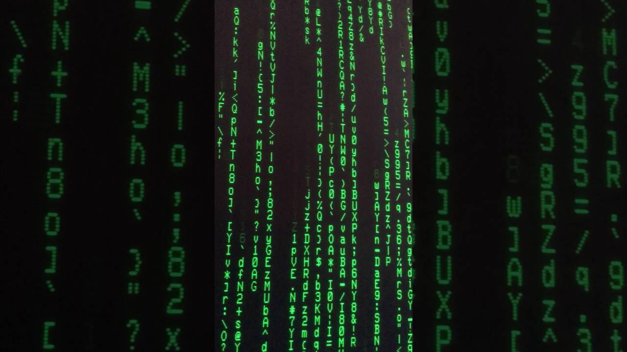

JWZ has something to show you (confusingly, a portrait screen showing a Matrix effect which makes it look like it’s sideways):
via @cjs in Displays for retro-computing - what do you use?
Here’s the video - one case where portrait-mode video is correct:
I can’t tell how much of that is phosphor persistence and how much is MPEG artifacts, but it seems to have some rather slow phosphors. (jwz mentions this in his writeup.)
